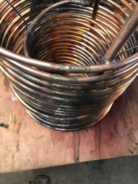

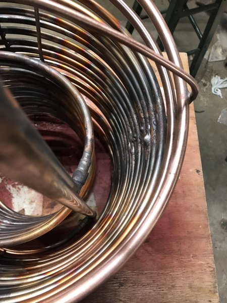

    What's a good easy way to clean copper minus the elbow grease method? I'm trying to clean my wort chiller (part of beer making)... buddy of mine brazed it. Which left it pretty dirty. I've seen baking soda and vinegar on the internet... but don't want to subject to damage, which could possibly off flavor my beer... :cheers:

    Lemon juice and baking soda paste on a sponge. A good rinse when done. Pretty safe.

    Is that HVAC silver brazing?

    I would double check that it's safe to use in a beverage application. I do a fair amount of silver solder work (not quite a braze but similar) and while it's a fantastic joint, it's prohibited for use in potable water systems.

    Form a paste from table salt and vinegar and scrub it down with a dry rag. The salt is an abrasive and the vingar is self explanatory for copper.

    Cadmium is what you should be worried about with HVAC Silver Braze.

    X2 on the Barkeeper's friend awesome for chrome, copper, stainless steel, porcelain and more and it's very cheap at Walmart!
