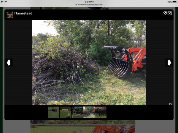

  12. Flamestead
    Flamestead
    Dec 7, 2013
    2,160
    10,926
    Windsor County, VT
    We sprayed some invasive s one summer (bitter sweet, multiflora rose, etc). The next year we rented a mini excavator to tear out the invasives and make small piles, and then used the grapple to move the small piles to larger ones. I borrowed the grapple from an uncle. It is an excellent tool.

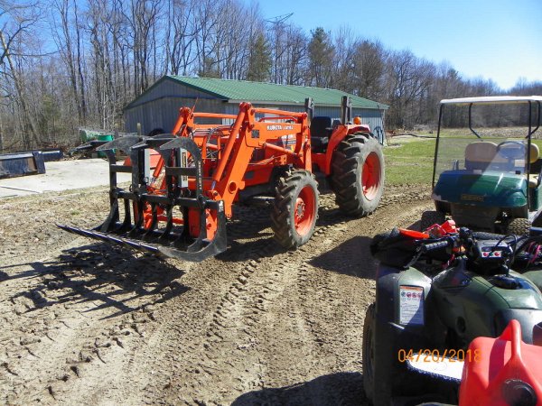

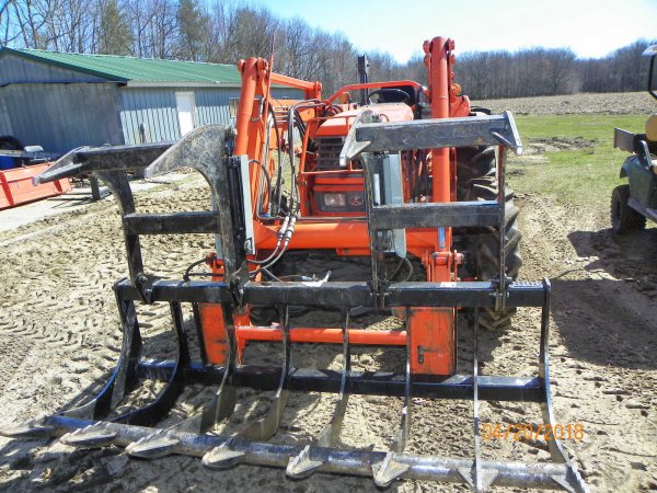

  15. Backwoods Savage
    46,966
    295,850
    Neighbor has this one. It is a beast for sure. I am amazed at how many logs he can move at one time. It would be too big for my tractor though.
