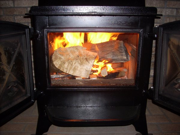

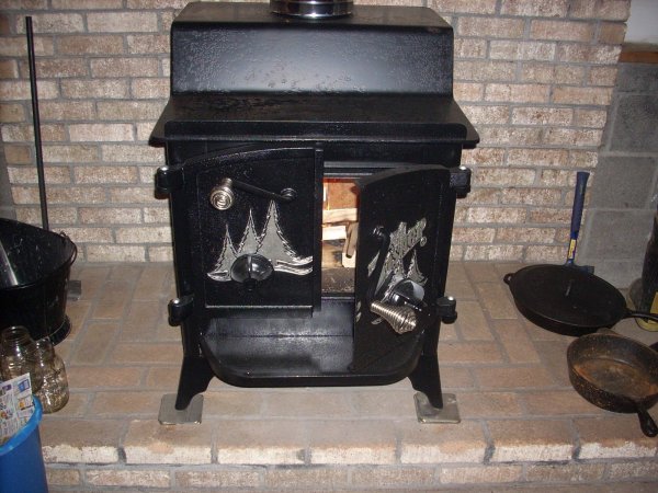

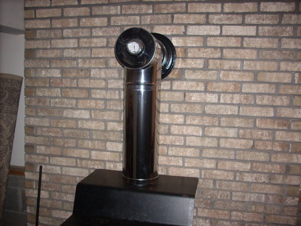

    Heres an example of my light off practice. This is my traditional "Halloween" fire for the kiddies! Not so much as a "fart" out of the stove! I open the door and had left it open for about an hour. In 10 minutes, my stack temp is already 300* I'll shut the draft knobs down to a half turn here in a minute and the temp will sit at 400* and not change!
