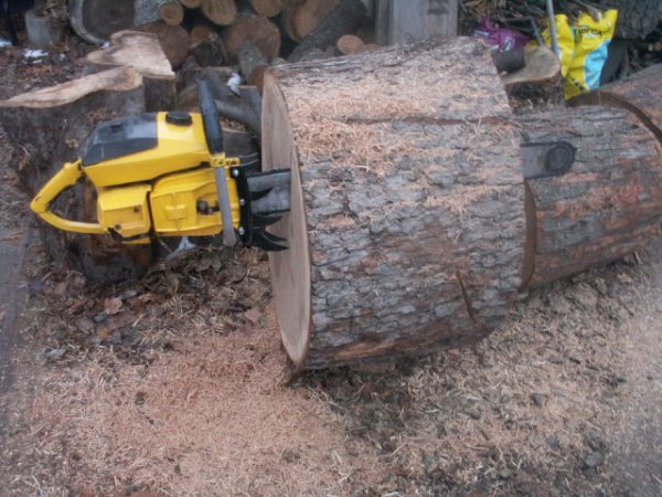

    These wont bend....;) :saw:

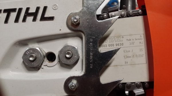

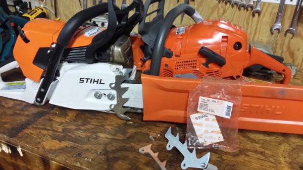

    I thought the kit I got for my 362 was the same? It may still fit, but the 362 needs a new inner spike. I just added an outer spike to the 441. I had a 2nd one and gave it to Mastermind for his 441C-M.
    All the outer spike has on it is 1117-B.
    But the spike kit for the 362 is for both spikes and has the chain catch (1135-650-7750) . I know the outer spike will work, because the 261, 362, and 441 all use the same outer clutch cover. But the inside spike may be different because of the mounting holes? I don't have my 362 here to compare, but someone should know.
