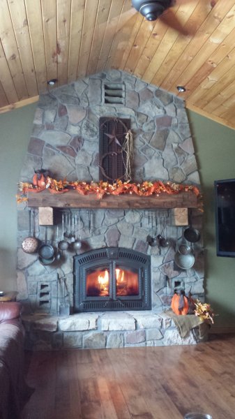

    To avoid confusion, an "insert" is installed in an existing fireplace. Unless you plan on rebuilding a masonry fireplace, you want a zero clearance fireplace, preferably a high efficiency unit. You frame in the opening to fit the fireplace, and make it look like you want.
    Like Scotty Overkill's
    http://firewoodhoardersclub.com/forums/threads/napoleon-nz3000-anyone-else-have-one.7234/

    Scotty Overkill has some great pics here of a similar looking doors.

    Welcome to the FHC, kotzfunkel! Sounds to me like you need an insert by the description of your existing fireplace. The fireplace I built is a ZC fireplace. That is to say it is a woodstove that LOOK like a fireplace, it's surrounded by a factory built fireproof box, and installed in a closet - like framed chase and veneered with stone or brick...here is my Napoleon NZ3000....
    While it looks like a traditional fireplace, it'd actually a very efficient secondary-burn stove that heats the entire house.
    If you are wanting to install a stove in an existing masonry chimney/fireplace your egging to have to use an insert.....
    There are lots of nice looking inserts out there. Also, I highly recommend installing an insulated liner in that flue. It'll draw better and accumulate less creosote than a traditional masonry flue..
