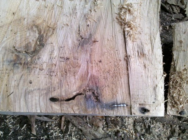

    Yep felt the saw grabbing , I thought is was more than just a knot, sure enough ,a couple of nails ,split one down the middle.
    First time for me hitting any metal , It sucks :(

    That sucks! Where was the wood from, a yard I guess? Looks like that nail was from awhile ago.

    Them nails do a lot of damage in little time.
    Better get the file out. Unless you have a grinder? Gonna take a little time to clean that chain up.

    Yes it was a yard tree from a scrounge, 2 more nails U cant see in the pic, , they were embedded, nothing to see on the outside.
    I'll go do some more splittin, deal with the chain later

    On the noodle none the less. You couldn't have aligned that cut any better.
    No tell tale stain on the cut end?

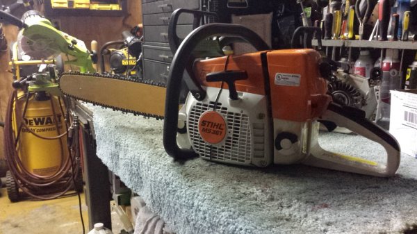

    They work and can get a pretty good edge. But, it's got a plastic frame, non adjustable head angle, and flexes very easy. It works, but takes a little finesse. I had one and got rid of it because of inconsistencies in the grind. Some like it. Some hate it. For $40, I would save an extra $60.
    The Northern Tool Grinder is $99 when on sale and has an adjustable head angle, cast iron construction, and comes with 3 stones to do all chains. The Timber Tuff model is the same grinder, just Green instead of Red.
    I've had a HF model, an Oregon, and now have the Timber Tuff. For the money, the TT or Northern is the best bang for the buck.
    You can see the TT (Green) behind the saw. And if you look a little farther right (just to the left of my tool box, and in front of DeWalt radio) you can see the Oregon.

    Hey I remember that bench

    I do see something I love using behind the saw..... SeaFoam!

    I have trees in my woods with barbed wire hanging out and still strung along in spots.. I cut them high, them low on the trunk.. Yes it's funny of all places you cut right in line with an 1/8 inch of steel. Go figure! If filing the cutter by hand after hitting steel, I take and file straight across until I have the very tip cleaned up, then bring the file back to the proper angle.. Makes quick clean up of the mashed tip..
