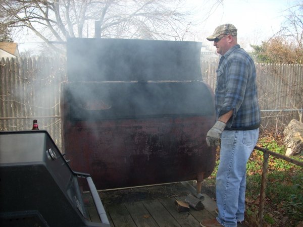

    Heidi, Thats a "SUPER" coooool Program. :cool: I've been making my grills like that for over 35 years, but never a old propane tank, they were all old oil tanks! When I retire, I'm going to build one on a trailer with a 500gal tank, it will have a Fisher wood stove incorporated into the heat source for smoking. I've drawn the plans up for it 20 years ago! Heres a pic of #5 Grill… She is almost done, on her last legs, they rust out. Grill #6 will be "VERY" special;)..
