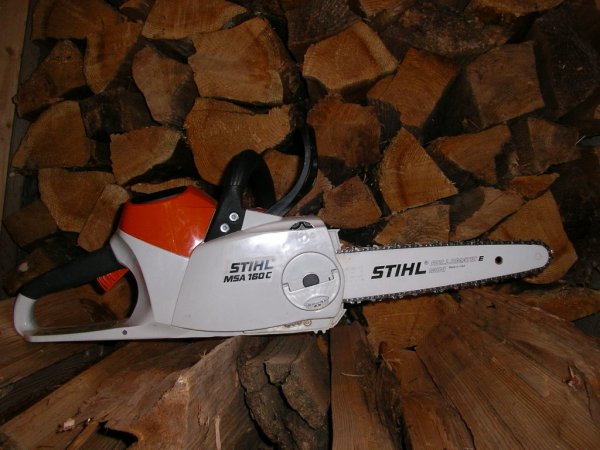

    Have had the Stihl cordless for seven years now .
    It has more power than the Homelite which it replaced .

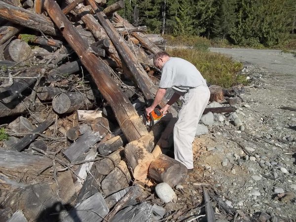

    The cordless saw goes along when I go scouting for firewood .

    The Stihl gives about 45 minutes cutting time on a charged battery but have never thought to pat attention to what the volume of wood cut is . The newer saw also comes with a longer bar .The only tool you have to pack is a file !
