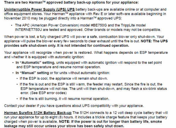

    What would be a good back up battery pack for a St. Croix pellet stove? We dont lose power often, but a couple days age we lost it for eight hours. It started to get chilly!

    Maybe I worded it wrong. I'm looking for recommendations to buy a battery for backup. Thanks for any help you can give!

    get a lifepo4, the largest you can afford. make sure you get a lifepo4 charger as well.
    without knowing the energy requirements for your pellet stove, I don't know the AH to recommend. Or if you need an inverter to hook stove and battery together.
