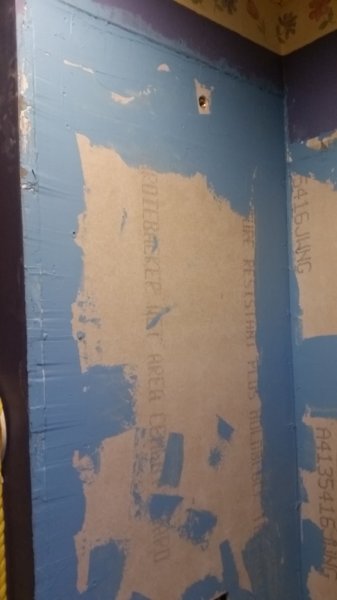

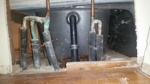

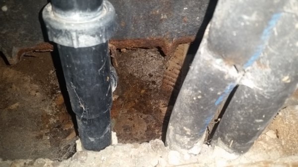

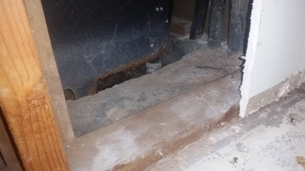

    20170104_182414.jpg 20170104_182438.jpg 20170104_121526.jpg This couldn't happen at a worst time. We're cleaning out a spare bedroom closet and noticed the baseboard has water damage, so we remove the carpet and the tack strip is moldy, baseboard only has water stains. I cut out the lower part of the sheet rock and no mold on it or the seal plate. My wife turns on the shower and I can see the tub drain leaking at the horizontal joint, the drain end of the tub doesn't sit on the slab but in a hole with the rest on the drain.
    I don't think the drain leak could fill up this hole and over flow so I'm guessing the tiles/grout/caulking come into play also. I begin to remove the old hard original caulk and a few tiles pop off, so at this point I'm thinking the tiles and sheet rock all need to be removed.
    I'm thinking remove everything down to the studs and put up hardy/concrete board and decide on the finished shower covering i.e. tile, surround etc.
    Did I mention our oldest daughter, husband and infant moved in with us today. :)

    Can you see the underside of the tub at the drain? Sometimes the rubber shoe gasket fails and water drips down the horizontal run.
    I've also see the plumbers putty dry out under the drain assembly and leak out there.
    Both of these are pretty easy fixes. This is where an inspection camera is so useful to find the exact spot.

    I still need to turn on the water again and check from the larger front cut out, neither way its all coming out. I'm a jack of all trades and master of none, so is concrete backer the way to go and what's the best surround, I don't want tile so how is solid surface/ stone ? We need to decide if the old tub is going also. Think I can get all this done in 5 days?:rofl: :lol::D:smoke::hair:

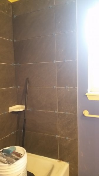

    Tile guy is scheduled for tues-fri, this included shower area down to the studs, new backer board, all new valve and fixtures and raising the showerhead. I've purchased the fixtures, tile, accents and shelves. I have to leave town Tuesday but my wife can hold her own.:)

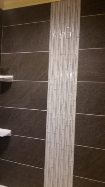

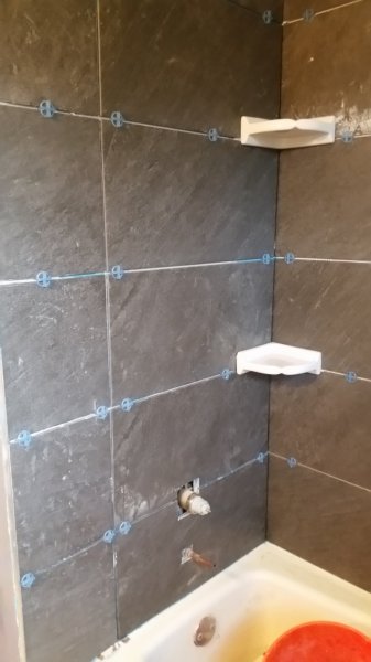

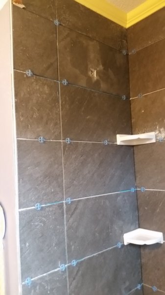

    20170112_083713.jpg 20170111_081009.jpg 20170112_083653.jpg 20170112_083704.jpg
    Almost finished, our house needs serious updating.

    Add water proofing (ditra) (membrane kerdi)to your list... Really surprised those "in the know" haven't mentioned it......

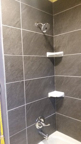

    Should be all dry saturday evening. 20170113_164708.jpg 20170113_164719.jpg 20170113_164725.jpg
