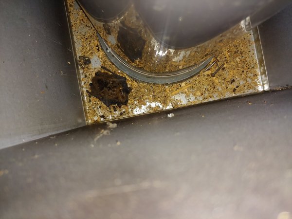

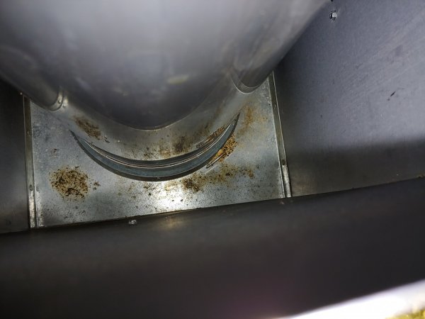

    Heard scratching a few weeks ago. It's when it was quite warm here. Today I finally have a Saturday off. I find this.
    It's very tight up there. Thank goodness for small phones with cameras. Otherwise it would have been flashlight and mirror trick. I managed to get most of the wood shavings out. Here's my question. Some is stuck. Would you folks worry about what is still stuck?

    It looks clean enough for me.
  3. Locust Post
    8,787
    50,887
    Looks clean enough but I'd worry more about sealing up their entry point
  4. brenndatomu
    23,460
    150,759
    There isn't enough left there to cause a problem...maybe a little smoke smell, but even that would be unlikely, and only happen once or twice, if at all.
