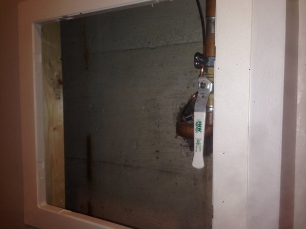

    I have pretty good access to see behind all 3 sides of exterior finished walls. Behind the upstairs chimney wall. They framed it out pretty far. The second picture is a water shutoff on the front wall of the house. I can see down the wall and feel the adjacent wall cavities. No insulation. The house was a flip so it's not a surprise they'd cut corners when they could.
