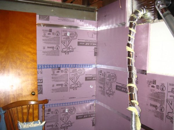

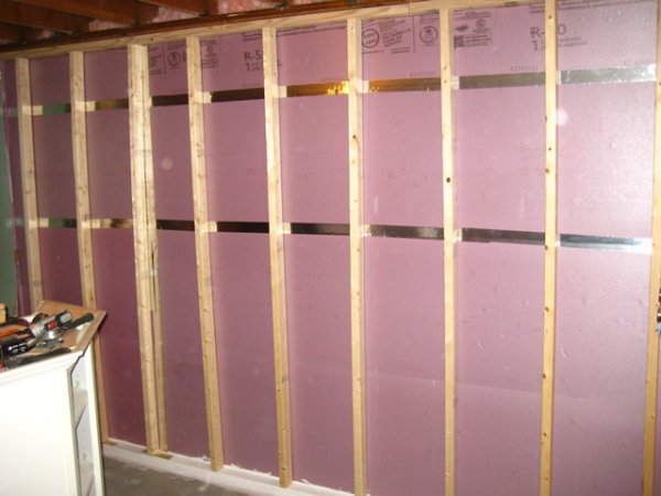

    In one section of my basement I put up foam board then installed the studs (2x3 wood) used fiberglass bats that were 11 or 13r, then put up wallboard.

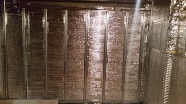

    Another section that I wasn't going to be able to attach upper support to the sill, I used foam board, then Reflectix, then the studs screwed into the cinderblock wall on top of that (metal studs so only about 3/4-1"), left the air space between the Reflectix and the wallboard.
    I used an IR gun a couple of weeks ago (during the deep freeze) to see if one section gave me a better barrier than the other. The readings were within 1/2* of each other - at right around the room air temp. So, it doesn't seem to matter if you use the Reflectix and air barrier or the fiberglass bats once you have the rigid foam installed - at least in my application.

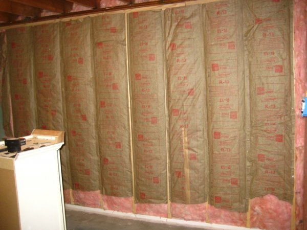

    Here is what I did in the first room: foam board, then studs with fiberglass insulation:
    Gym Foundation Wall New Studs.jpg Gym Foundation Wall Batting Insulation2.jpg

    Here is another room: foam board, reflectix, metal studs:

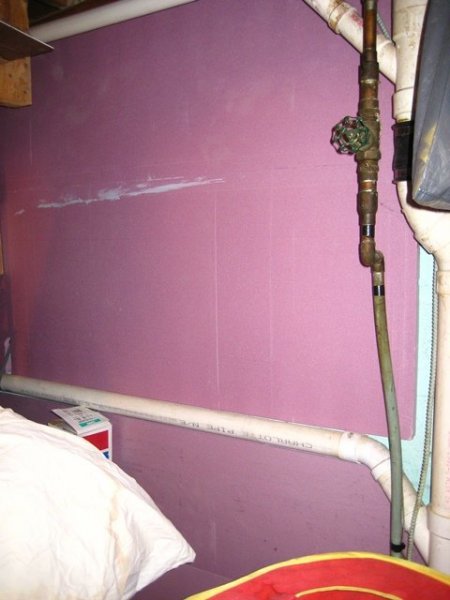

    I ended up cutting around the drain line for the washer and to the main drain also. I do have a couple places for the FHW pipes that I didn't have room for foam board so I did just do a layer of Reflectix. Because I know where that area is at, I can see it in the pictures of the metal studs in my earlier post (upper left corner). I did put up foam as close as I could first.
