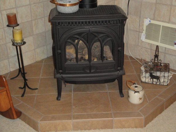

    If you did change your mind about propane, you may want to look at a Jotul. I have one in the basement in our family room and it does a nice job of heating the basement and even has heat flowing up the stairs. The flue runs through the basement wall.
