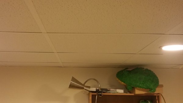

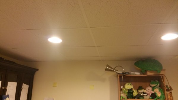

    I used 6" recessed cans. I'll shoot a pic when I get home.

    sorry for the delay guys... here the pics. I zoomed so you could see the unavoidable gap where the tracks meet with the ceiling max system.

    Thanks a lot.
    Couple questions, do you remember your floor joist spacing?
    Are those 2'x4' standard ceiling tiles?

    16" OC and yea 2x4
