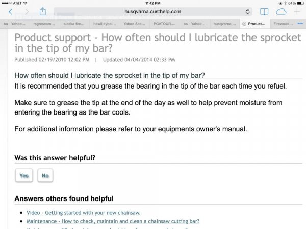

  5. bogydave
    Also
    Husqvarna says weekly on the " needle bearing"

  15. cat-face timber
    cat-face timber
    May 14, 2014
    16
    14
    I grease the bar tip every time I add fuel.
    Always have, always will.
    I also grease the sprocket bearing, everytime I clean my saw.
    It helps me sleep at night!
    Agreed, the Husky grease gun is a POS, I have one of those handy grease guns that you have to fill, I just use the same grease that I use to grease my pickup/jeep with.
