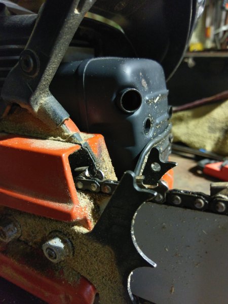

    I run 20" on my 2166. I have a 24 that I only mount if dealing with big wood. I find the standard husky 24 bar to be an OK balance, but would prefer a lightweight. I ran the big felling dawgs for a while, but switched back to double mediums. Just finished playing with it a bit after mounting a new muffler and an 8 pin. The original muffler had the gill and screen up top, found this one NOS on eBay. What a difference in sound. Quieter I believe. Hard to tell of any gains loses with the new bigger sprocket.

    Do those dogs give enough room to keep the wood off the muffler? The stockers on my 372 would allow the wood to rest right on the muffler that’s why I went to the big ones. They look cool, but are pretty excessive and I’m sure I will bend one into the chain at some point.

    I've not had any issues with contact that I can recall. I will try and remember to get a profile picture to show their size. I think they are bigger than the single that came with the saw, but smaller than the big west coast style which looked mean but are way overkill for what I do.
