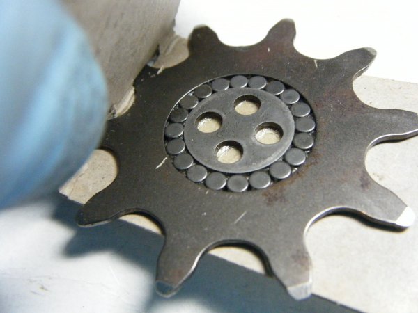

    I grease every few tanks of fuel. Like The Wood Wolverine said I can't see too much bar oil making its way in where it is needed with centripetal force working.
    Take a look what is really in a bar tip. I think those nice little bearings need a bit more than bar oil. I also think with the viscosity of grease being heavier and staying where it should it helps keep the dirt out and off the bearings increasing longevity.

    Good pic,. Makes more sense to grease after seeing that
