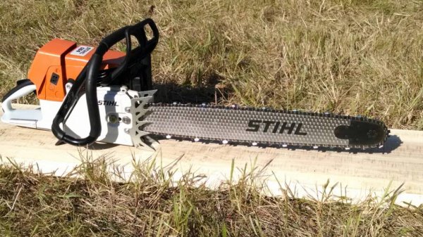

    Is that bar engine turned? Looks sweet!
    Shawn Curry and Well Seasoned like this.
  8. Deererainman
    Deererainman
    Oct 3, 2014
    501
    2,782
    Union City Ky
    It was done by a fellow going by Homelite410 that's on this site. He does good work. That Stihl logo is machined/recessed. I have some of his bar adapters, very nice quality. We need to get him to post em up over here, if he hasn't already.

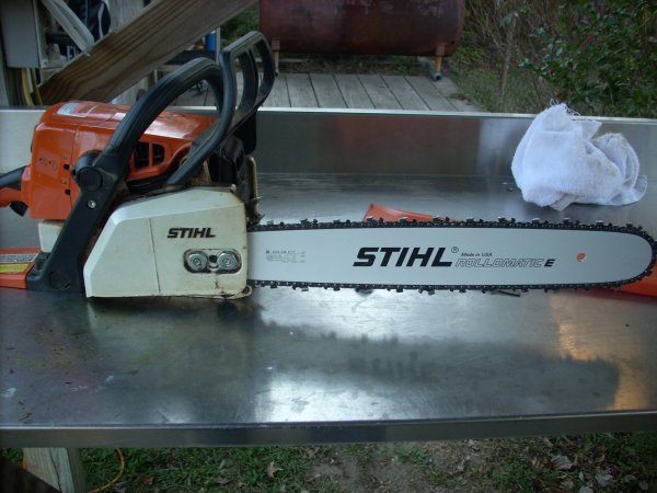

    Well, I'm back…. $40.00 and tax…. Had to have it! :zip: Dealer said I'm not the first one this has happened to on this model… Hmmmmm….:confused: I saved my receipt incase this one S#!T's to bed any time soon DSCN1821.JPG
