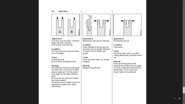

    I have a problem with my Stihl 260. When I am making a cut in a larger round-10" or bigger- the saw pinches in the cut and/or wanders off to the side-I get a crooked cut.
    I know I am not a wizard with sharpening, so I suspected I had a chain that had teeth that I had not sharpened evenly. However, the saw does the same with a new chain. I now suspect the bar. It is the original bar. I have probably cut 30 cord or so with it. I don't recall ever pinching it or twisting it, and I file the burrs every time I put a new chain on.
    Any thoughts? I am ready to buy a new bar but I thought I would pick your minds and see if anyone has any thoughts.
    Thanks.

    Are the rails at the same height on both sides? If one side has worn (or been filed/dressed) lower than the other it can cause a crooked cut. Also, check to make sure both rails are straight with the bar and not flared outward.

    I am using 3/8 on that saw. I'll look at the bar closer-I don't mind replacing the bar-it is 5 years old. I just wanted your thoughts. Thanks.

    A replacement bar that size won't be very expensive. Unless you have a collection of long or expensive bars I wouldn't bother with the tools.
