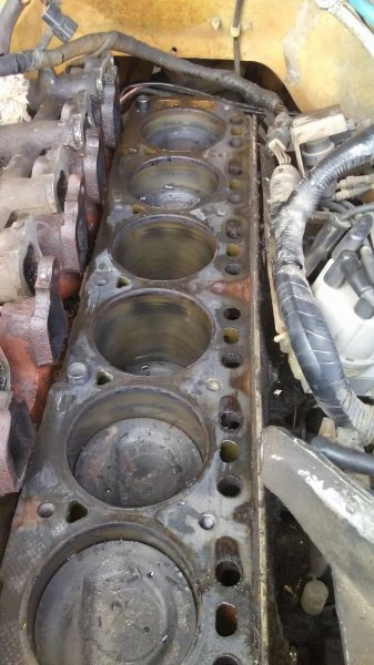

    I took the head off the truck today (1991 f250 300-6) to see why it was overheating and one of the head bolts was broken (that's where the head gasket failed too). Looks like it was broken for a while. The part of the bolt in the head was rusted in pretty good, but did come out. I will try to remove the piece in the block tomorrow. Everything else looks ok after a quick once-over. I have a new gasket coming tomorrow and will have to locate a new set of head bolts. I'm not sure why it snapped, but my only thought is someone over tightened them and broke it or it broke soon after. I got the truck years ago as "scrap" and was told I should drive it to the scrap yard. I fixed it up a little and have been using the heck out of it for over 10 years. Maybe the guy knew the bolt was broken? Is that why the valve cover bolts were loose? I don't know.
    I am amazed the truck ran like this for as long as it did. I have pulled 20k lb trailers and hauled beds full of firewood with a bad head gasket and broken head bolt! It has been overheating randomly since I got it, but I figured it was just low coolant from the small radiator leak for the first few years and just kept it topped off. I swapped radiators and that one started leaking too after a few years. Now I know why.
    We'll see how tomorrow goes and play it by ear. We have a few blocks/heads/engines sitting around, so it's not a lost cause if the head or block turn out to be bad. I have a different transmission to swap in anyway, so pulling the block wouldn't take very long.
    I'm hoping to have the truck up and running in the next week so I can get more firewood and plow any snow we might get. (We've had plenty of snow)

    I hope the bolt in the block is flush, or close enough, so you can weld a nut to it and turn it out.

    Yes, the bolt sticks up just a little, so I can clean it and weld on a nut. I'm going to stick a nut in the lathe and remove the threads and taper the inside so I can get a better weld. My plan is to let it cool, then heat the block a little and use some oil while turning on it. I'm hoping it comes right out. I ordered more parts this morning and they will be in around noon.

    I got the broken head bolt out. I tried twisting it with a vice grip, but it wouldn't budge. I turned a nut in the lathe so it was tapered inside and no threads. I ground the top of the bolt for a clean welding surface, set a washer over it, then the nut and welded it on. Let it cool for a few minutes, heated the block, gave it a wiggle with a wrench and it came right out. Textbook removal, which I greatly appreciate. I scraped the head and block and checked for flat. The head is .002-.003, but well within service limits, so it's going together. The block is good to go. The valves leak a little air, so I'm going to check them out tomorrow. Hopefully they can be lapped and seal up. I covered everything for the night and will get parts in the morning. The valve stem seals won't be here until tomorrow anyway, so I figured I'd make the most of today and get it cleaned up.
