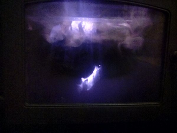

    Tried another backwards burn tonight, and got a great result!
    Sorry my photos are so poor, but there is just a little glow right in front of the doghouse, and very active secondaries. There is a sustained glow way in the back of the firebox, and the wood is just blackened at the front, with no sign of active burning other than the glow in front of the dogbone.
    At the moment, STT is 550 (IR reading), flue temp is 450 (Condar probe), both steady for about 15 minutes now.
    The wood for this load is 3 medium splits of pine. The coals were piled about 6 inches high, and pushed back against the rear wall, a little higher against the secondary manifold in the center than on the sides.
    Air is set about 1/2 inch out from fully closed. I'm going to let this burn untouched and see what happens.
    I think next time I might try a E-W split or a higher BTU wood in the front, on top of the N-S load, to see if I can get a longer sustained burn that way. The thinking is that it will take a while to coal so far from the intense heat in the back, and therefore will sustain the burn a long time.
    Other ideas welcome.

    So you load N/S and the splits are sitting on the coals pile in the back or just in front of the coal pile?
    If on the coal pile then they are soaping down toward the front?...and you end up with a lot of space in the front below the baffle because the splits are higher in the back.
    If just in front of the coal pile then you must be using short splits?
  17. bushpilot
    bushpilot
    Feb 25, 2015
    3,240
    14,356
    Eastern Washington
    On top of the coals and sloped to the front. Yes there is space on top in the front, it is not the tightest way to pack a stove.
    DaveGunter likes this.
