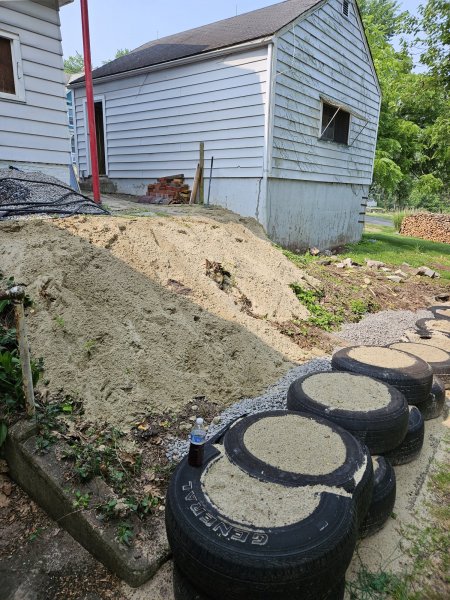

    The retaining wall is finally underway.
    The initial 20' will be used for cordwood, after that, I just want heavy material around the garage foundation.
    I have 3/4 stone immediately behind the wall, about a foot.
    They recommended "sand fill" which has some small stones in it.
    1) not so sure that is the best material, it needs tamping I think....water application didnt make it firm enough to walk on alone.
    2) it seems to drain well, like sand on the beach, the water just disappeared.
    I don't have wet ground, no water moving around. The only water will be rain/snow.
    I liked their "aggretate"3/4 grey stone with stone chips/sand. It packs HARD but they didn't seem to think it would drain well.
    They also thought sand fill would be a better product than "dirt fill".
    Am I moving in the right direction, or would a different material be better as a back fill?
    Edit: around the garage, on one side, the wall will hold driveway parking.
    The wall will be 10 feet wide. At its deepest, might be to 6".
    Sca

    Part way through today's progress....and my ever present broen eyed girl

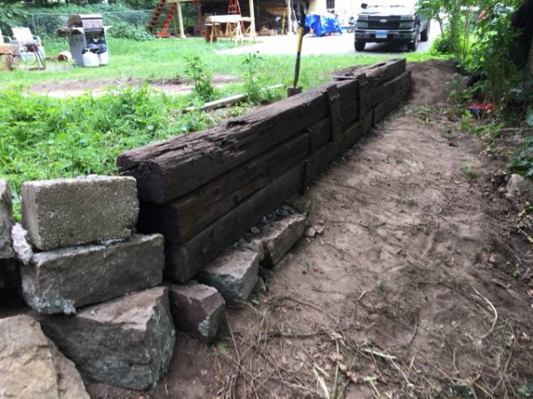

    Just an amateur here myself. In 2020 I built a small railroad tie retaining wall as preparation for the 16' pool I put up that year. From what I was reading, drainage is important for the long-term integrity of the wall. You don't want to be holding back a mini reservoir. For backfilling I just used the native soil I had in my backyard. What I did before backfilling though was to put a layer of crushed stone down for drainage. To keep the soil from migrating into the stone rendering it worthless, was to cover the stone with drainage fabric. So in theory, surface water passes through the backfill material, through the fabric, then the stone, then eventually makes its way into the sub soil below. So far the system has had zero issues. Oh, I also used crushed stone as a base for my wall too. Maybe that's a moot point, but its what I did. If the fabric idea appeals to you, I have an extra roll of it kicking around you can have.
