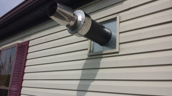

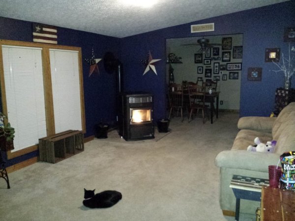

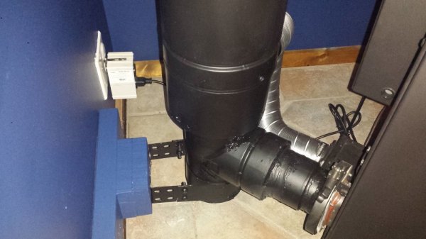

    As long as you meet the Manuf recommended height clearances (12"-24") from the ground and clearances to windows or doors (4' in most cases. Some stoves are 18" if an OAK is used). Here is my 2 set ups. Freestanding upstairs we use in the shoulder seasons or for an added bump up in temp, furnace is used for colder weather.
    Here is the upstairs stove (Enerzone) and it's exhaust. The OAK is integrated into the venting. It's a 4" vent inside, and the air is drawn around it (O.D. Is actually 6") which preheats the incoming air and only leaves one hole in your wall, as opposed to 2 holes.

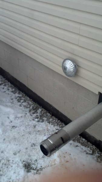

    And here is the Furnace. It has a 4" vent as well, but has a separate OAK. This is the cats meow. Dealer close to me has a close out sale on 2 of them. One used (showroom) and one brand new (old stock). I picked mine up for $2,000 on CL 3 yrs ago and it came with duct work, venting, and back draft dampers. Love it.. This one just makes clearance from ground by a few inches, but it's legal.
