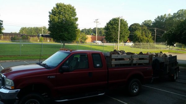

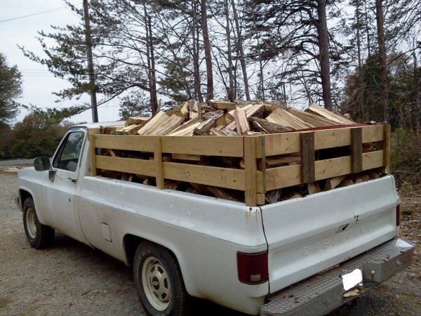

    I always make my own from expanded steel. Grind it downs a little and paint it black. I build pressure treated wooden side racks too to double the bed capacity of the truck. Something like this, I'll see if I can find a picture of the headache rack section. Pressure treated wood for stake pockets you can get free at Lowes, the pressure treated lumber comes on it and they throw them away. They work great for making the stake pocket stakes.
