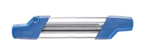

    Even with the 2 in 1 files, putting the bar in a vise is a big thing to keep the saw from moving.
  20. Horkn
    28,549
    161,517
    Just get a pferd csx aka 2 in 1 file, and a vise.
