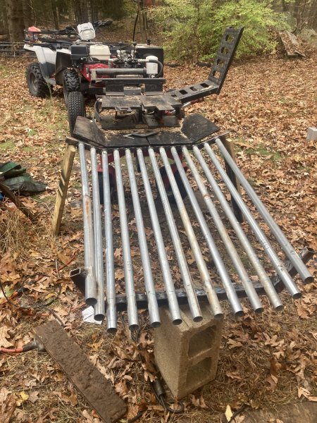

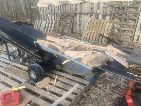

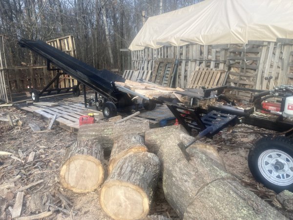

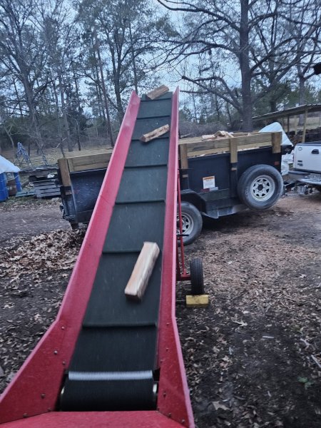

    One year ago plus a day I started filling this pen. Sold it this fall. Facebook just informed me of the photos I posted last year. Stranger things have happened.
    Grizzly bars are working ok so far. Seem to like the bigger rounds so there’s four splits running at a time. Keeps things going straight. Ran a little less than half cord through it. We shall see how time treats them.

    I know you got a great set-up there. You did a great job on that box wedge.

    Getting it done Joe. :thumbs: That splitter kicks azz.:axe: :dex:
    Just so i understand...what exactly are the grizzly bars?

    Their job is to shed splitter waste. Usually there’s a set at the top of the conveyor with a chute to kick the crap back towards the splitter area. Conveyor only reaches about 12’ high and I use every inch of that. No extra height for bars there. So I thought I’d try a set before the conveyor.
    Splitting fresh green wood mostly except for those white oak rounds with punk so there’s less crappola.
    I have a Yard Glide ordered. Hoping I drive right over the top with the splitter and then just pull all the waste into the trails and flip it over. We shall see how that works too.

    I just reverse the conveyor, park a trailer under it and flip it on the conveyor by hand.
