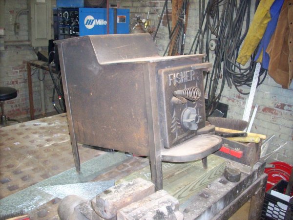

    My sister picked this up 20 years or so ago. It now resides in our camp. I'm thinking that it is a Baby Bear knock off. It It has no name plate or other tags on it, it doesn't say Fisher anywhere on it.
    Yikes, I need to move the kindling/tinder supply a little further away. Didn't realize how it had collected so close.

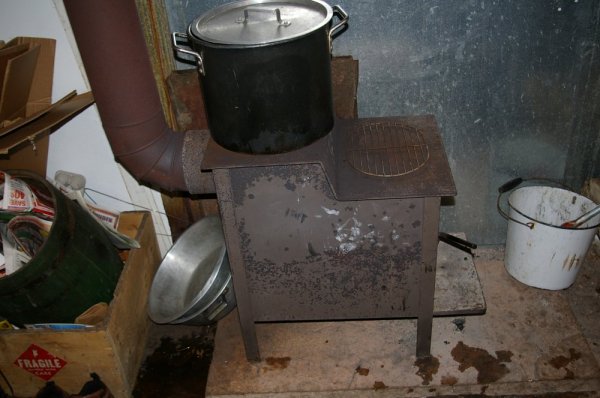

    You could easily be right. It is possible that this was finished off post-factory. It is well put together and looks pretty close, just the door and ash tray are off. My sister's acquisition of it 20+ years ago brings it back close to the dawn of EPA regs.
    And she burns fine. Plenty of life left in it. It is used a handful of weekends a year.
    This one that I pulled off google does seem to have the same legs.

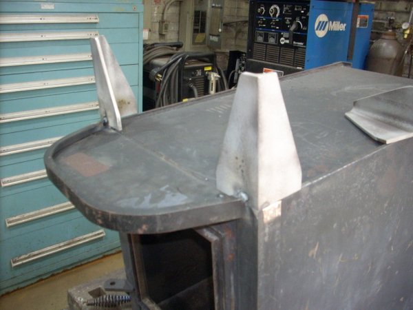

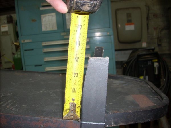

    Theres a picture of a Mama bear someone cut the legs down to fit it in a fireplace opening, I had to rebuild the legs and I put a newer style design on her. The other picture is a baby I got that was a bit rough, she is now restored.
    I'm not 100% sure, but I'm willing to bet your ?babybear?;) was a stowaway at one time then finished.
