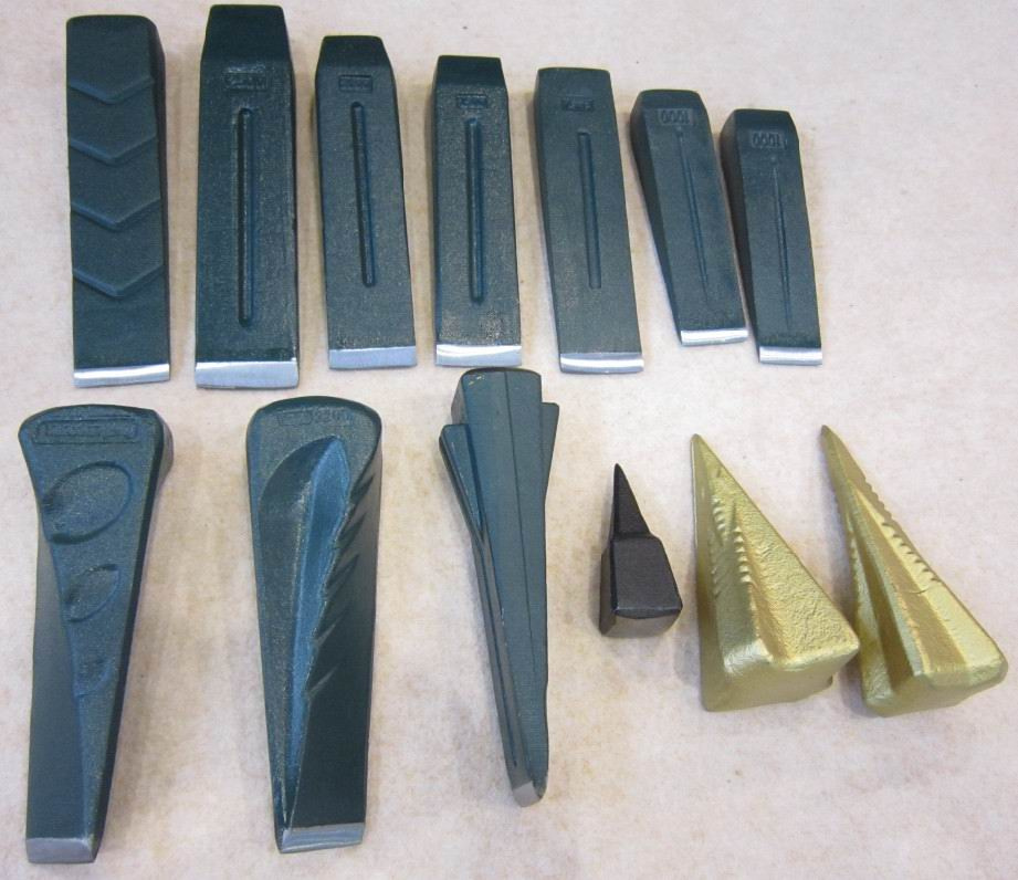

    With Helko/Mueller twisted wedges,vintage Stanley 20lb sledge.........

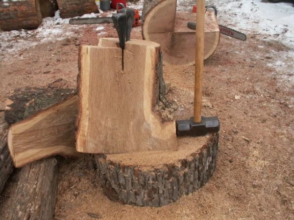

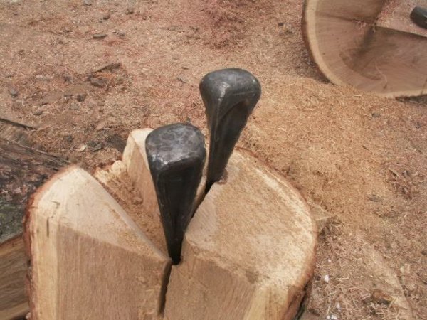

    When the maul does'nt work it is time for the wedges and the sledgehammer (up to 20 pound weight if necessary). A wedge with a blade and a wide head which twists as it is driven in (as in the first picture) is, in my opinion, the best one to start an opening in a really difficult round. The 'wood grenade' type with the point at the end and a more or less circular profile, performs poorly in this instance, because it exerts force equally in all directions, instead of concentrating along one line of potential weakness. A lot of wedges have a narrow head and don't open up a difficult round sufficiently for it to split. However, it is at this point that the 'wood grenade' sometimes comes into its own, since its wide head is usually capable of completing the job. Does this make sense?
