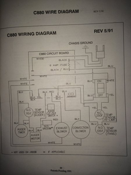

    This is a 1995 Jamestown J2000 FS pellet stove. I replaced the vacuum switch and the auger still does not keep running after starting the fire with the gel. No igniter.
    This auger cutoff switch seems to be faulty. Do the newer stoves have this switch?
    Is it worth keeping?

    Newer ones dropped it.It detects auger jams and turns off motor.The motor you put in would probably eat through jams that would ruin old motor.Reccomend bypass.

    Thanks Bob
    I really appreciate your comments.
    I did bypass it and the stove works good now!
