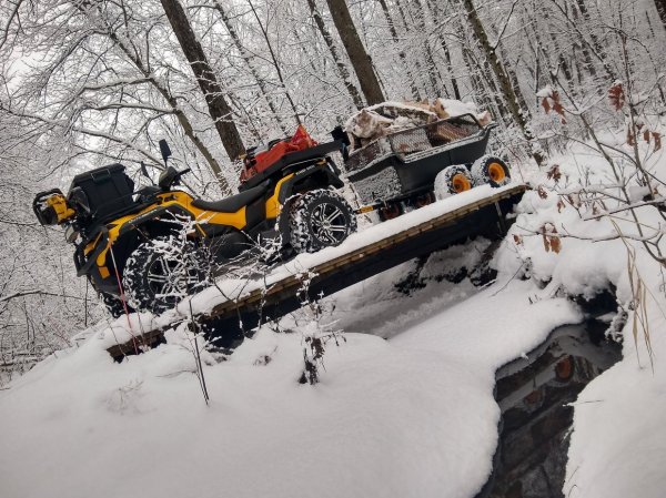

    One can get cargo in an ATV. I'm an ATV guy myself.
    Here's mine:
    jo191145, Horkn, sms4life and 6 others like this.
