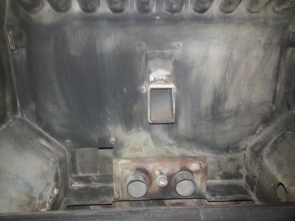

    Had a fire in the ash pan....shut it down for now. Any opinions on the possible cause? Thanks for the help!

    Gonna give her a good cleaning this morning and fire it back up. Need to set it with my magnehelic (sp) gauge later.

    The exhaust port...If we're talking about the same spot, I call it the damper. It slides to regulate the air. Clean as a whistle in there, had the blower off last week and saw it from the front and back.
    What I think caused the fire...Been turning stove off and on quite a bit and at start up it dumps a few pellets each time. I believe they built up and caught fire.

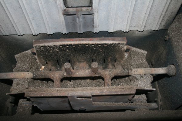

  18. jtakeman
    12,091
    54,507
    The first pic is what tipped me off to adding ash on start up before I made the mods. Notice the ash fills the void where pellets can sneak over the edge on start up.

  19. jtakeman
    12,091
    54,507
    This pic of the ash pan is my first fire after cleaning and adding ash to the sides. I used to get a good bit of loose pellets in the pan. Once I added the ash I saw little to none!! I should have taken a before to show them, But this is after and I only saw 1 loose one in there!!
