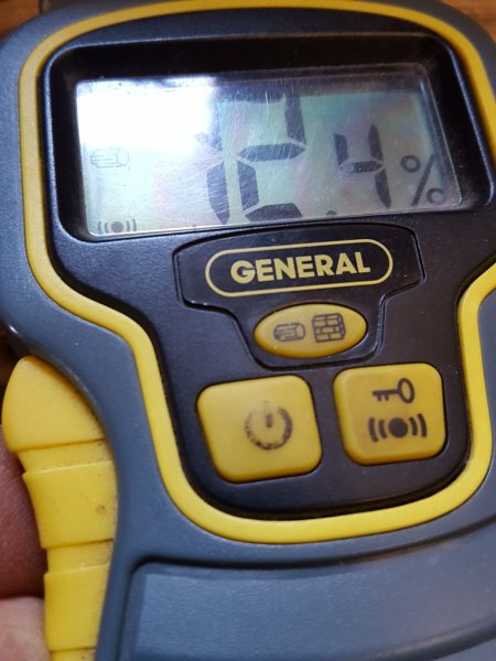

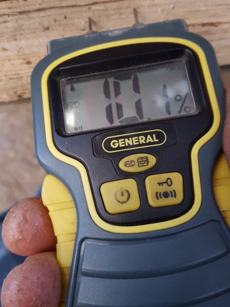

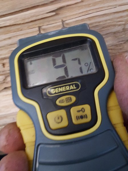

    I just had to check.:picard:Cut this dead ash 11/19. Split and binned 11/20 and put in the pole barn.
