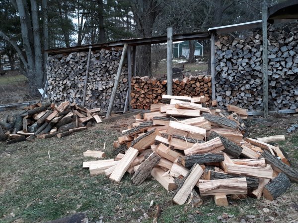

    20220113_161955.jpg Everything will get stacked single row and catching the wind and sun as much as possible. These are my racks but his will be basically the same.
