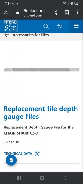

  10. ammoaddict
    ammoaddict
    Dec 21, 2021
    677
    4,164
    Granite Falls, NC
    Is this what you got?
  11. cezar
    cezar
    Oct 12, 2021
    394
    1,588
    KY
    After a good nights sleep, I decided to revisit this. If I go to the Stihl 2in1 sharpener webpage and click on warranty, I see no mention of the 2in1 sharpener, but it says hand tools have a lifetime warranty. Other than rental use it seems like the bare minimum warranty on EVERYTHING is 1 year at least. So I felt pretty good that this ~8 month old tool is covered.
    So I drive to my local Stihl authorized dealer where I bought it from and speak to the manager who flatly declines to replace it, citing a policy that they only do warranty replacements on Craftsman products.
    Well screw me right? I deeply regret buying a Stihl saw now, because if they're going to refuse covering a $50 hand tool, then they're DEFINITELY going to be deadbeats if anything happens with my $500 saw. I should have just bought an Echo.
    Absolutely fuming.
