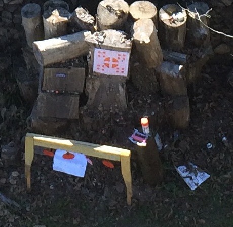

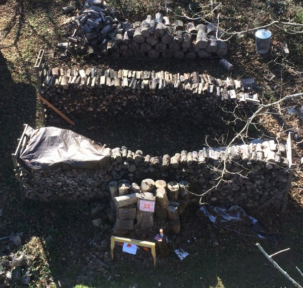

    This is the best picture I have of mine (taken from 40’ in the air so the angle is weird). They’re 5” disks I attached chain to and sandwiched the chain between two treated 2x4’s then ran a bolt through the lumber and the last link of each chain link. I just pound the legs in the dirt about 8" so it's portable. It’s held up so far from close to 1000 rounds of handgun, .357 mag through a rifle, and I have no idea how many .22’s I've shot since I built it in July. I’d probably have to beef it up some to shoot 5.56 at it, but for something I threw together in 30 minutes with scrap chain and lumber it does the job. It sure beats punching holes in paper.
