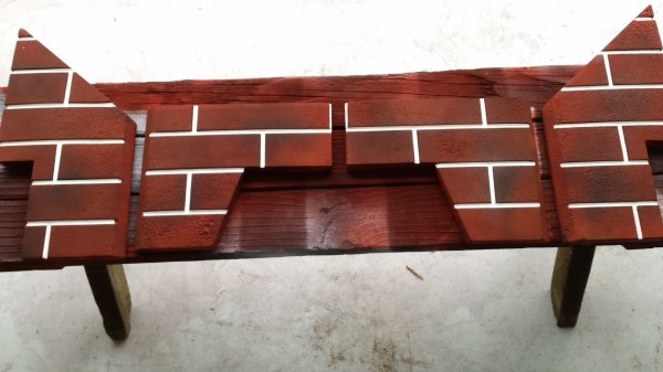

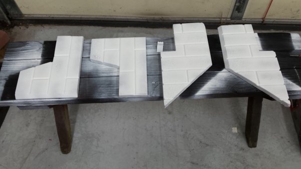

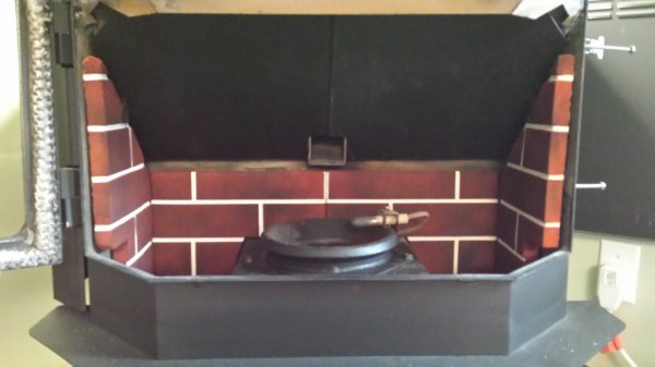

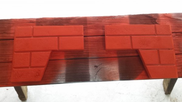

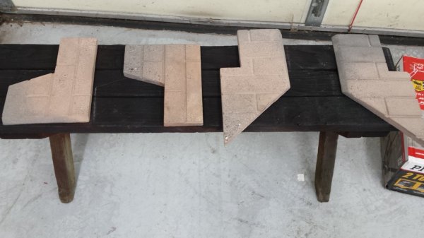

    20150808_140908.jpg 20150808_151325.jpg 20150809_141531.jpg 20150809_145310.jpg 20150812_102225.jpg
    Well not the whole stove, but the brick inserts. I also used the VHT 2000 paint, then cured them in my power coat oven.
