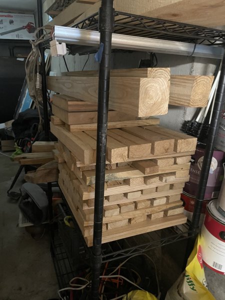

    About 4’ sections, but only 5-6” diameter. I’m sure I could do longer pieces provided they’re relatively straight to begin with. I wouldn't hesitate to try larger stuff if I have a solid setup. The 3 square pieces on top here are 3x3” American chestnut and were run through the bandsaw. Everything underneath was done on the table saw.

    Pretty impressive stash of material. Have any specific plans for it's use?
    Don't think I have ever seen American chestnut.
  10. Eric Wanderweg
    7,433
    57,608
    American chestnut trees themselves have been considered functionally extinct for 80+ years so not too many people have seen the lumber from them. There's a market for salvaging the old stuff from barns and farmhouses, but new lumber itself is long gone history. So far the only plan I have is to build a rustic bench for my kids. Bigger picture though, I want to keep saving as much as I can, from the rare old wood I find to the recently killed smaller stump sprouts. Eventually I might want to make tongue and groove flooring if I get enough of it.

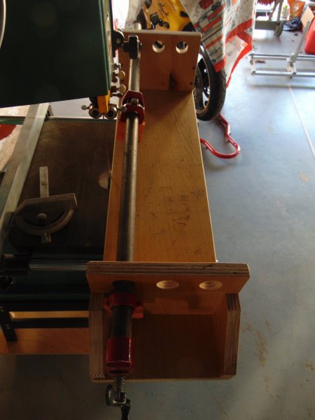

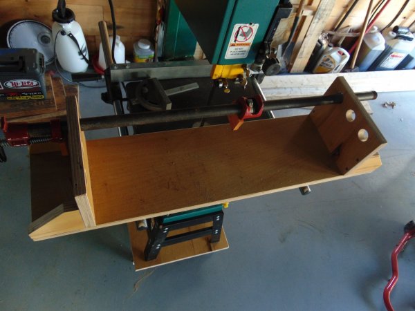

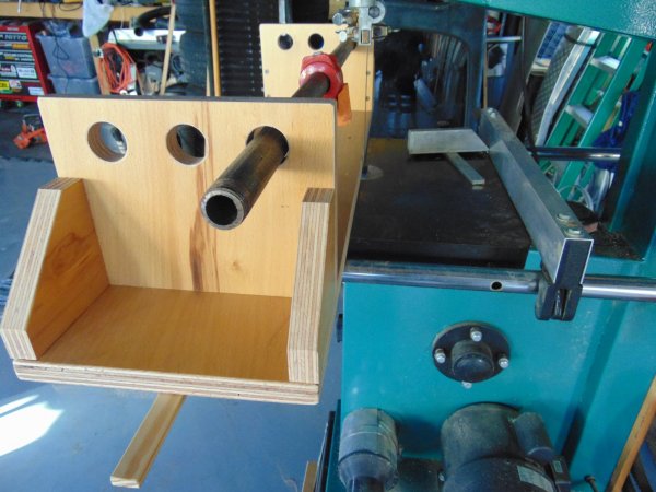

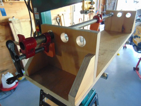

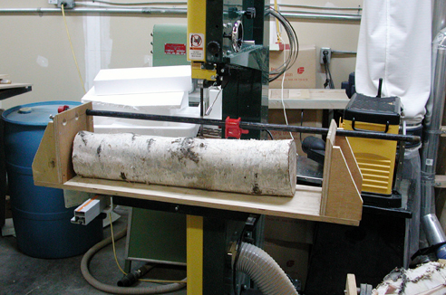

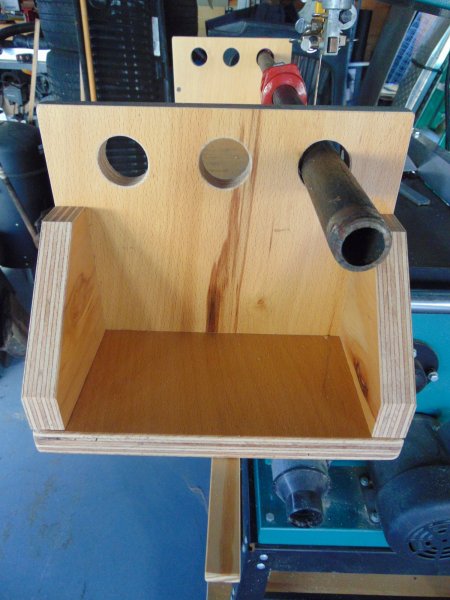

  11. The Wood Wolverine
    17,304
    108,665
    I’ve done it Brad. I made a sled to clamp firewood size pieces (that were tiger maple) and sliced them into about 2” boards. Made some tool handles for files and ash shovels. Still have a bunch of em to make picture frames or something when I get the wood shop set up. I have pics on the laptop. I’ll dig em up and share asap.
  12. The Wood Wolverine
    17,304
    108,665
    This was the internet pic that gave me inspiration.
    Once you have a flat surface, a resaw fence could be used to make the rest of the cuts. Wider the blade the better for that.
