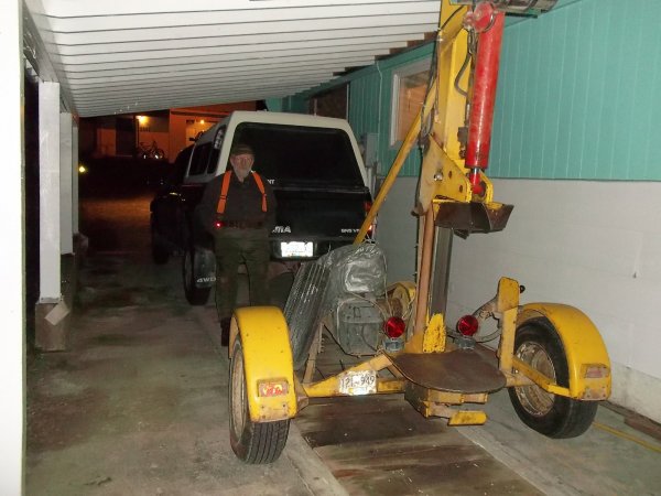

    The splitter runs 14" tubeless tires, but the tires are the only suspension the axle has so I only run 8 PSI in them. To avoid having flats all the time I had tubes put in each tire. 100_0871.JPG
