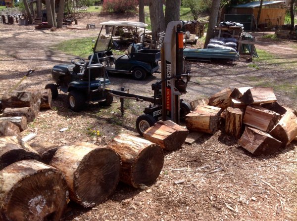

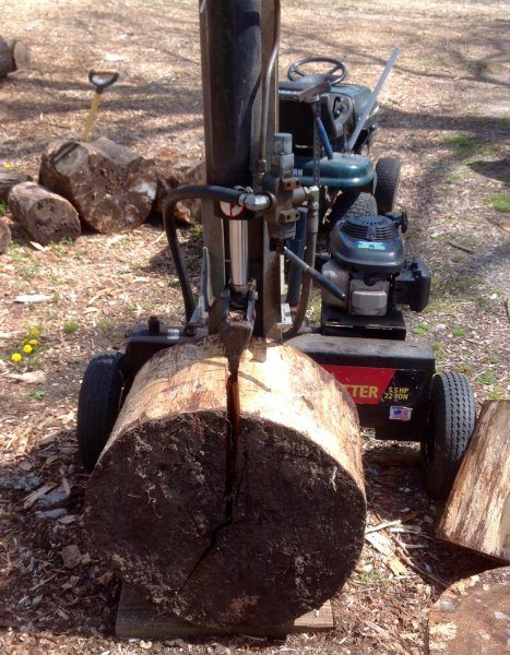

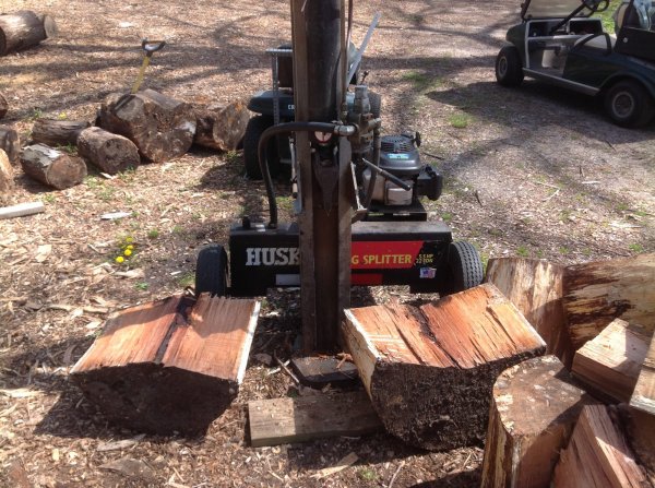

    Have a bunch of big rounds to split and really don't like wrestling with them when they don't split cleanly in half. I tried rolling them on the foot of splitter and the weight of the half rounds really help them to come apart cleanly. Only had one round that I still had to wrestle with.
    I halved and quartered around 12 rounds and now will split normally. All red oak.

    clemsonfor , MikeInMa I've done both ways in past but this was FAST. Just rolled onto foot and boom 2 halves. Then tilted and flipped half to make a quarter. These rounds have been sitting for a year so I stripped off bark the other day ( 2 green landscape barrels full). They rolled easy to splitter. Now to finish up and do more

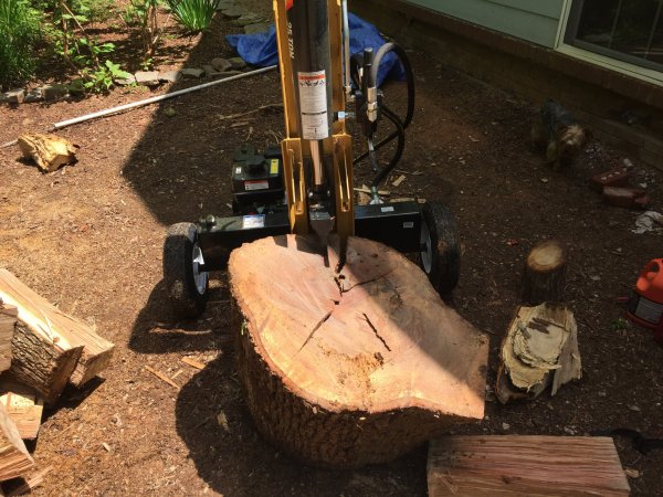

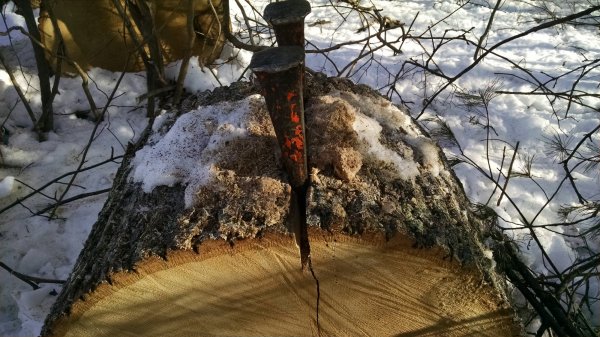

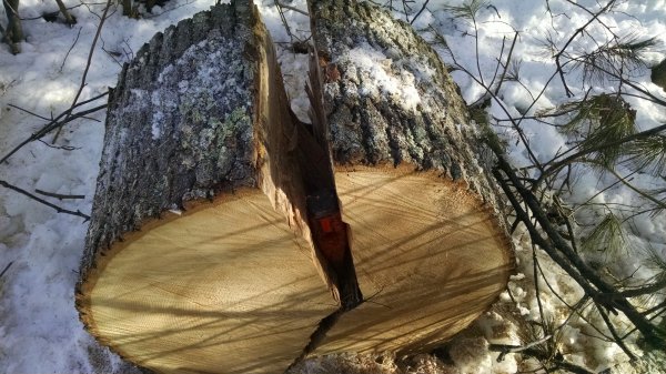

    I thought about doing it on this stump cut the other day, wouldn't half or bust with multiple saw strikes

    Flip that round to the other side and see if that helps getting it to split.

    I don't do this too often but with strait grained wood that will roll onto foot of splitter, it's easier than splitting normally for me. The biggest round I can roll onto splitter would be 26 inches. That's with splitter wedge all the way up.
    What I like best is the weight of the round helps finish the split. The little stringy bits of oak left connected between the two halfs break quickly as the round opens up and falls to the ground.
    Once it's in half I flip it on the flat and split it normally but with the flat against the beam of splitter.
