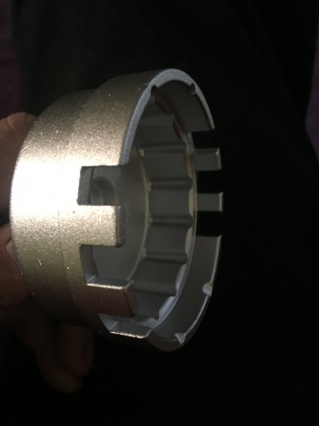

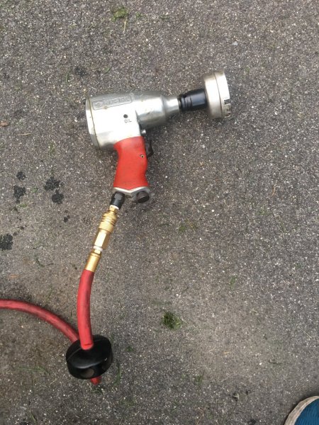

    Well I was Successful !! To tell you the truth, I used my air wrench and 24 MM impact socket. I set it to loosen and put it it on to the oil filter fully. Pulled the trigger 2-3 times before it started to loosen, then it loosened right up!
    If you do not have the OEM Toyota Steel cap socket and an air impact wrench then forget it!!
    When I put it back, I used a regular wrench and just did it hand tight. :)

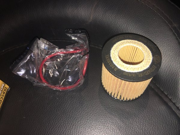

    The old filter was very dirty!
    All Done!

    I have changed those filters a lot. The correct tool is a must. If you take off the little round cap with the 3/8 square drive you can drain the housing with the little plastic funnel that comes with the filter and o rings. Some snap in others thread in. It sure does cut down on the mess. Make sure you lube up the new o rings with fresh oil that will help you get them loose next oil change. Oh when you do break the cap which has happened to me a few times you can get an aluminum one from Toyota which I think is better since it doesn’t get brittle with the heat cycles.

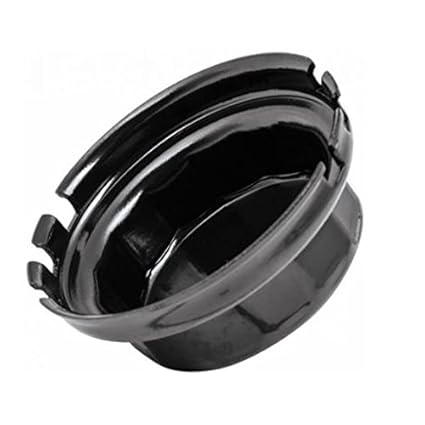

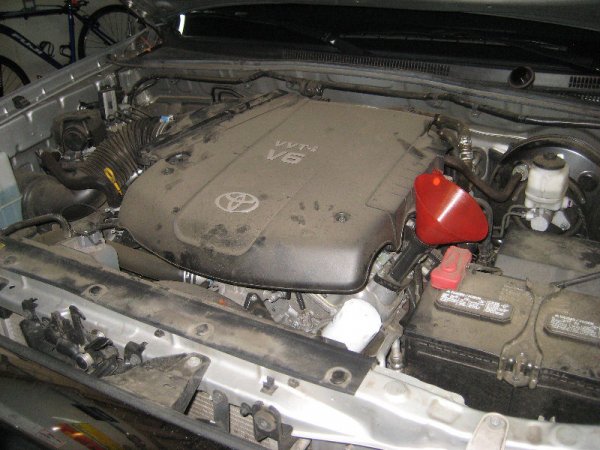

    My truck has the absolute best oil filter arrangement I've encountered. It's right where it should be, up front, on top. What about the mess when you pull the filter? Well, those Japanese engineers have that covered. There is a catch around the filter mount with a small drain that you simply place a used water bottle, etc to catch the drips. (don't forget to remove when finished :emb: ).
    I'm not sure if this design was intentional or if it was a necessary evil to fit the V6 into the frame? Either or, I am thankful. IMO, this is how they all should be. The Toyota filters have an anti drainback valve, so the filter will hold oil even when inverted. I buy them by the case for $4 a piece and they come with new drain gaskets.
    Edit: Not my truck, stock image. Mine is much cleaner in there!
