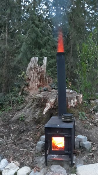

    I wish I had taken progress pics when I burned a 4ft maple stump. Every October I take 2-3 weeks off. For 2 years, I was burning that stump on my October vacations when I wasn't hunting. With the size and vegetation behind it, I couldn't try to burn it all at one time. I also wanted to keep the old fir stump it was sort of connected to.
    What worked for me was to start my fire in one of the big crotch areas where the roots flaired out and made a pocket. Then I took a sheet of steel and leaned it onto the burning area to direct the flames and heat toward the stump. The steel was a huge help. That and just feeding the fire for days. I even got a pickup load of pallets to feed the fire.
    Part of the stump is still there, and there's a cavern where the fire followed one of the roots. I still dump weeds and grass clippings in it.
    The best I have on my phone is a before pic. Ignore the pyrotechnics in the foreground.
