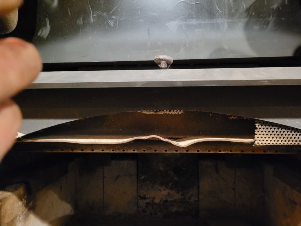

    I have had mine for 6 years.
    The top retainers were both replaced at 3 yrs.
    The center one bowed down again, which let the damper rod fall out of the plate.
    Taking all of this apart it looks like i need to replace all the metal inside the box.
    Oh and the air wash for the window fell apart at year 2.
    I am hoping they are easy to work with.
    Invested alot of money in this.
