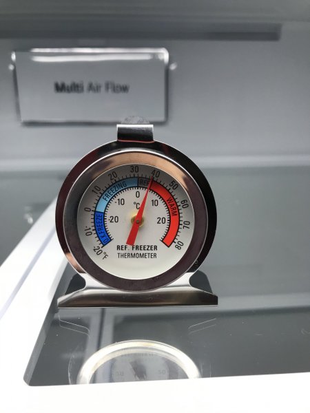

    We just got a new refrigerator and the SET temperature is a nice digital LED display. Why does it not show the actual temperature besides the fact that they may no longer sell separate refrigerator or freezer thermometers?
    So I just put it in there and waiting for it to settle.
    Is this accurate?
    Research shows the refrigerator section should be under 40 Degs F and Idealy 37 Degs F and the Freezer section should be 0 Degrees F

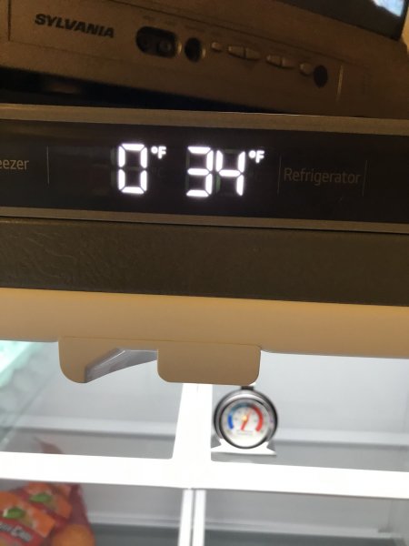

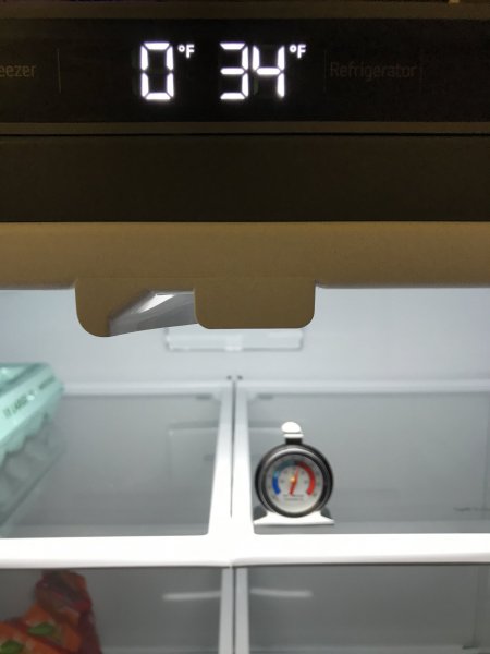

    After 45 mins the thermometer settled down to 40 Degs F so I changed the default SET temp of 37 Degs F to 34 Degs F to see if it will come down a bit.
    Looks like changing the set temp to 34 Degs F after 30 mins brought the refrigerator temp down to 38 Degs F so I will change it to 33 Degs F which is low as it can be set so it will be close to the ideal set temp of 37 Degs F
    Anyone else do this?

    So After 24 hours I changed the set temp to 35 Degs which seems to keep it into the recommended range under 40 Degs F. So it varies between 32 and 38 Degs F
    Thanks

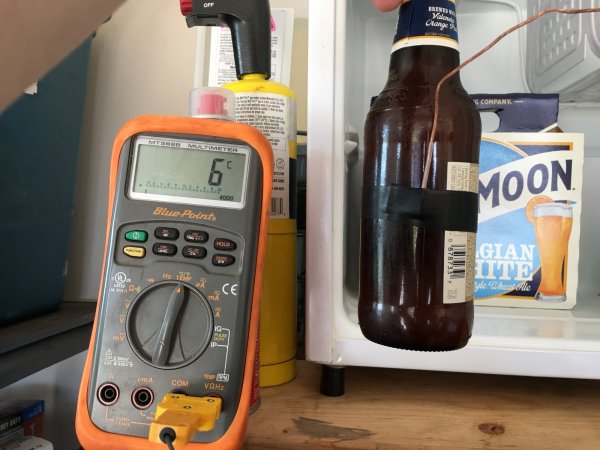

    Type K thermocouple plugged into a multimeter. Cheap (and old!) dormitory style cube fridge with a 0-9 dia for temp settings. As mentioned before, if you are measuring the temp of food inside the fridge, the readings will be much more representative of desired operation.
