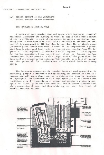

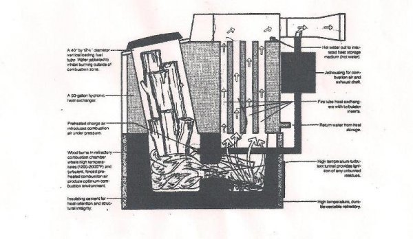

    I believe there's some truth in it. I heat with gasification and storage. Gasification boilers gain a lot of the efficiency by burning their own smoke (1,350 degrees plus). I don't want to call it luck or good planning but with my wood drying system, I can get the wood well below the 15% moisture level. The Jetstream boiler is a forced combustion pressurized fire box that allows only a certain amount of wood by gravity into the combustion area. If the wood is under 15%, the amount of wood that enters the combustion area has to be reduced or you get the smell of burning creosote downwind which is not pleasant for the neighbours!
    A diagram of the insides of a Jetstream.
    The Jetstream burn Chamber
    The Jetstream Chimney burning at maximum efficiency.

    Hey campinspecter thanks for a well thought detailed counter perspective. I guess every rule has an exception.:handshake:
    now my question how does turning down the amount of wood used in your system a negative? You’re using less wood with a lower MC?

  13. campinspecter
    campinspecter
    1,680
    12,217
    It's really a gain in efficiency in the range of 5% to 15%. I'm not burning wood to dry out that remaining moisture trapped in the wood.

  15. campinspecter
    campinspecter
    1,680
    12,217
    The manual in the Jetstream says it much better than me!
    Rich L, Marvin, Horkn and 6 others like this.

    I re-posted these as pictures.
