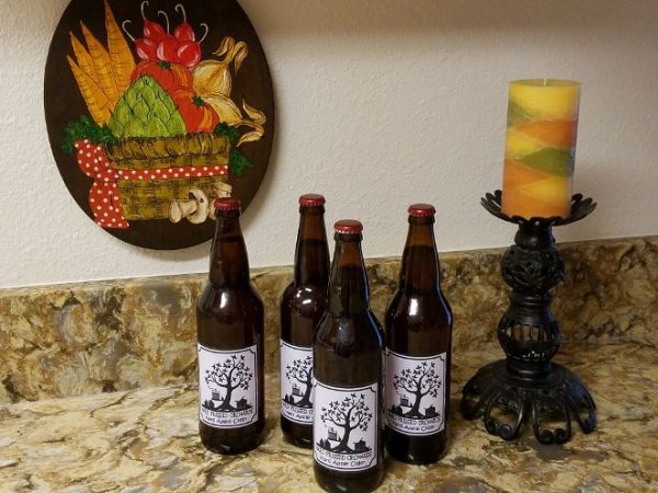

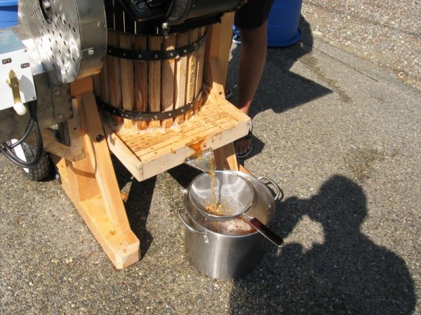

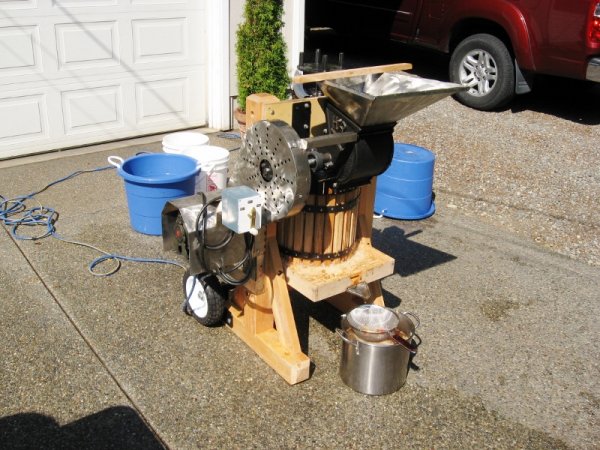

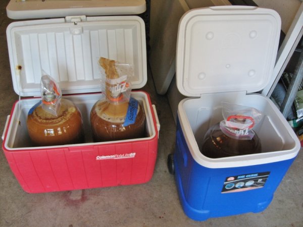

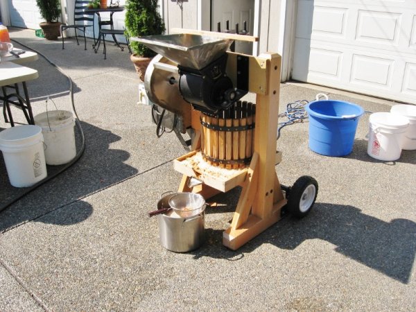

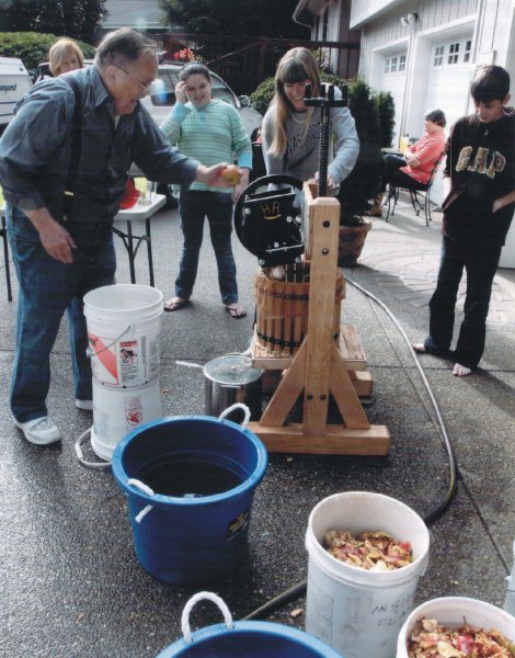

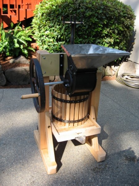

    Quite a few years back I broke down and bought a Happy Valley cider press and grinder kit. It was the "Homesteader" model as I recall. I did all the woodwork and some extra metalwork. I then found another HV grinder at a garage sale and made another press using a scaffold jack for the screw. This one I later motorized and sold the first IMG_1025 (800x600).jpg IMG_1029 (800x600).jpg IMG_1034 (800x600).jpg ciderpressjpeg.jpg bottledcider.jpg . I get apples for free at a local orchard park and also have bought some from a local produce store. I get the blems very cheap. One time I had close to 60 gallons of cider in the chest freezer (may as well, I can't seem to put an elk there). It keeps forever frozen. I have made 20 gal of hard cider. The first 5 gal we drank just to get rid of it. The second 5 were OK and the last two batches were 1st class! A golden mellow semi sweet personification of apple scented goodness that also has ALCOHOL in it! And pressing apples is FUN. The first time I used the press in the front parking pad the neighbors came out of the woodwork and rushed off to buy apples to grind and press. Everybody was searching their fridges for milk jugs to clean out to hold the fresh cider. People I didn't even know started showing up. We all had a blast and the kids loved cranking the grinder and pressing. I felt like I needed a shot of insulin after drinking so much juice. Our current supply of bottled hard cider is beginning to take a hammering as the weather heats up so come fall I guess I'll start grinding again! metalcuttr

    That looks like a great fall party! There's only so much fresh cider a person can drink, so why not get the neighbors over. Great that you had success making tasty bottled hard cider, I think that would be what I'd focus on. I live in an apple growing region (NH) but it's not on the scale of where you are. The local orchards press their own cider, and some do a much better job than others. My fave goes for $3.50 a half gallon.

    Hi Midwinter , You do need a grinder. My press has a grinder and hopper on it. You grind into the barrel, lined with a nylon mesh bag and then slide the barrel under the press. They come in all shapes and sizes. There was someone on Youtube (they have LOTS of cider press stuff) who made an apple grinder out of a small electric Harbor Freight yard grinder. Look up "Happy Valley Cider Presses" they are expensive but you can get a kit like I did for less. You will also get a lot of background info. There is another outfit out there that is cheaper but I can't remember the name. If I find it I'll post it. Don't forget Craig's List and Offer up. metalcuttr

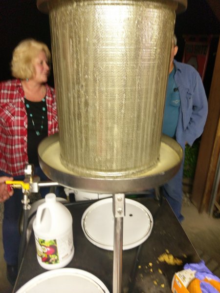

    My aunt & uncle have a sweet cider press. They had a little family get together last year and made some fresh cider. Don't have a picture of the scratter, but it was electric. This press uses what looks like an airbag off a Semi truck. It is inside the middle of the drum, which is like a mesh. Insert cheese cloth, dump in apple scrattings, hook up garden hose to the bladder (air bag) and lookout...cider begins to gush out. I had never seen this type before. They actually bought it to press grapes for their own wine. It was quite expensive (can't recall exactly what cost was) but works fantastically well. cider.jpg
    Ah, here we go....not the exact one, but close.

    Hi RCBS That is a new wrinkle I have never seen before. In a million years I would never have thought of that. I may not rush out and buy one but I am always interested in innovation! Thanks for the link. metalcuttr

    I was pretty blown away by it. I have been to an orchard that had a press that took up a small barn and have seen the old screw presses, but that thing was cool! That particular Aunty and Uncle are always up to something neat. They have about 40 grape trellises in their front yard for the wine making efforts.
    I can say with certainty that those particular presses work VERY well. Again...pretty expensive, but the old adage...you get what...

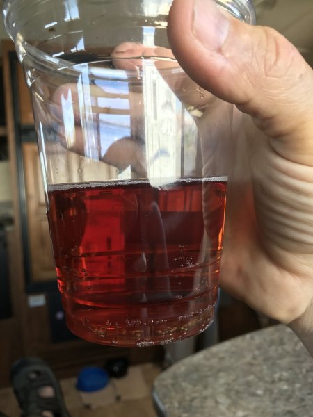

    I make lots of hard cider. I tried the fancy cider route but find it just as great to use tree top juice from Costco. Ferment to dry with Nottingham ale yeast. Sorbate and backsweeten with frozen apple juice concentrate (insert favorite flavors here) and then keg. Super cheap, gluten free, alcohol adjustments with brown sugar before fermentation ( I shoot for about 7.5%), and it gets clearer and tastier with age.
    Blueberry in the keg right now plus 5 gallons in the carboy finishing up that will become a raspberry cider.
    Super easy. No cooking or hops schedule like with beer. I like the tree top juice because it is heat pasteurized and consistent.
