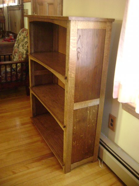

    I built this bookcase using the jig a few years ago. I like it better than my biscuit joiner.

    Jon, nice job on the bookcase.
    Ply for all the panel work, or did you edge join boards?
    I see some hardwood edging on the shelves, so I'll guess ply for all that, at least.

    Right. Oak ply for the shelves, oak nosing for the front edges. The top is edge joined, salvaged from an antique quarter sawn dining room table top, the sides and back panels are salvaged quarter sawn oak panels from an antique armoir. This piece is maybe about 80% salvaged wood.
    One thing about the jig. I tried to save a few bucks and use oak dowels from a box store for the plugs. I could not match the diameter of the dowels to the plugs, so I buy their plugs as they are a very nice, snug fit. Live and learn.
