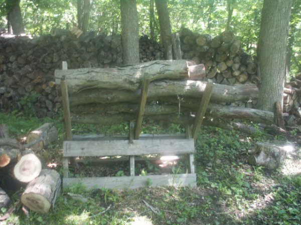

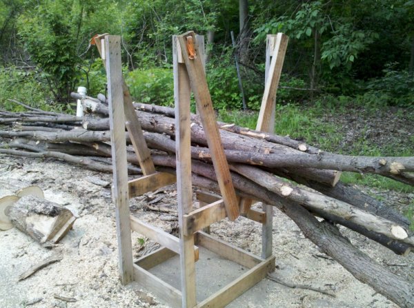

    I dug through my junk pile of scrap treated 2 x 4's & 2 x 6's (dumpster finds from jobsite I was working at some years previous) one day & built this in July 2012.Even the 3" galvanized screws were free (leftover odds & ends from cleaning out/sweeping employer's tool trailer) . Most have a little twist/cup/warp & nothing was over 50" long.
    Not pretty but its hella stout,very close to 100lbs empty.It stays in one spot. :D

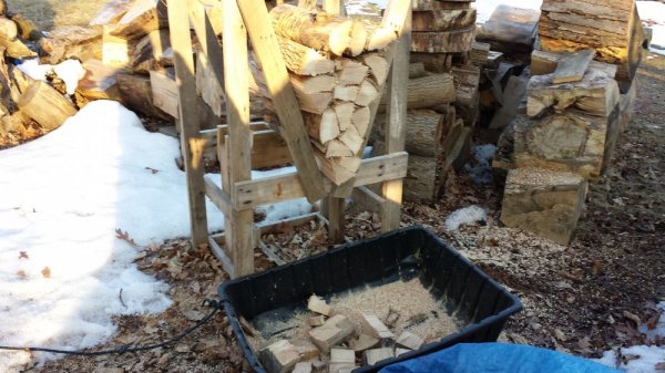

    Like this?
    HDRock, capetownkg, thistle and 2 others like this.

    The only variation upon stinny's creation that I would make would be to put it up on a stack of pallets. No bending over when loading/unloading it, no bending when sawing, and a bigger area to let the cookies collect in before you need to clean them up.

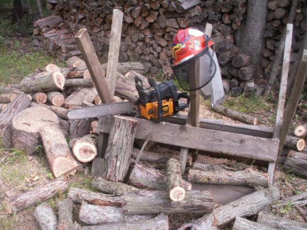

    Ok here is mine. :dex: I have project pics upstairs that I'll get up as soon as I can for ya.

    Also I took a peice of threaded stock that I got at Farm and Home that's 1/4" by 18" and drilled a hole in my bar on the saw. It's set at 17" which lest me walk down the log and notch every 17" so there all the same. I'll get picks of that too. Probably tomorrow night.

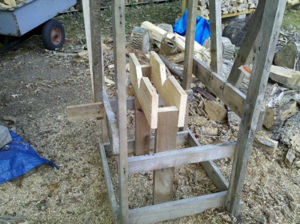

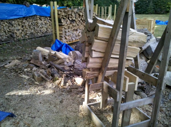

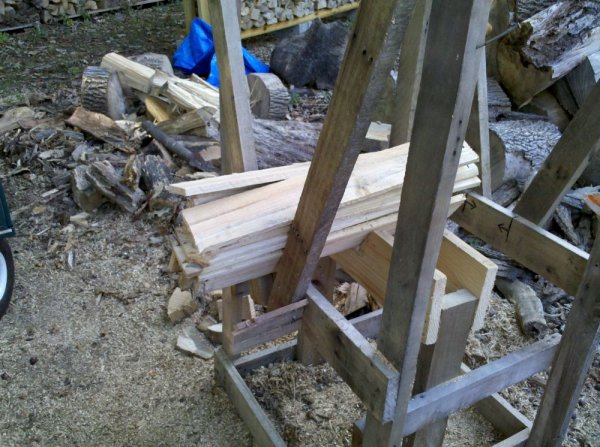

    I use this for pallet wood boards , poles ,splits and other stuff that's a little to long
    Oh ya ,it's made from free pallet wood
    IMG_20130930_163900.jpg IMG_20130608_194827.jpg IMG_20130930_161217.jpg IMG_20130930_161721.jpg
