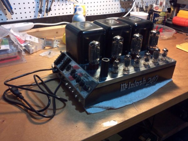

    Oh yeah! Nice Mac Jeremy. I've got a pair of dynaco tube monoblocks, but don't use them much any more. I have to admit, I don't much like the word audiophile, but I'm an audio nut for sure. I mostly work on the other end, making the sounds, which I have done on and off for income over the last couple decades. Just got a call today and will be mixing a record this weekend as a matter of fact. Of course, that gear lust eventually bleeds into the listening room too, so I've got some stuff on that end. I haven't kept up with modern times though, my main system is a SP-10 running through a fairly cheap rack mounted preamp/mixer deal into a Mac 2200 driving a pair of L-200 cabs. I've got quite a few thousand records and mostly listen to those as source material, but when I'm lazy it plays Pandora just as well. Nice thread!

    Thanks. It was a basket case I picked up in 98 for a bit under a grand ( insane what the collector market has driven prices too now) silk screening all gone but from the serial I identified it as late 62 / early 63 production. Chrome is pretty decent. I did a full electronic rebuild - full cap job, all new tubes, new hexfred diodes and upgraded it with a kit that added extra filter caps and better resistors in key places.
    Sonically its probably better than factory but cosmetically its not collector condition.

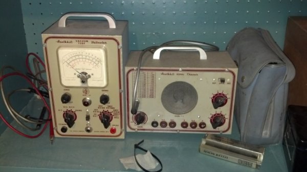

    Yes I guess the word audiophile is kinda loaded... Im more into it as a vintage nut. Another teaser and I'll elaborate tomorrow. Fighting off a cold and need sleep.

    That little signal tracer makes a sweet little guitar amp. I bet you knew that though.

    I didn't actually, intersting. I'd be interested to hear more of your studio experiences though maybe that's worth its own thread?

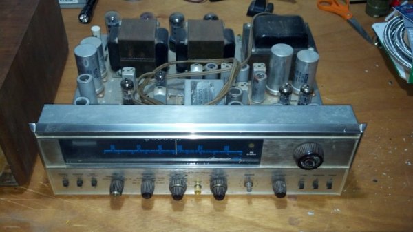

    Ok, so some background on that basement shot. Like I mentioned before Im not sure Id call myself an audiophile in the sense of guys who live this stuff and but all their gear off the stereophile recocmended list. I like vintage audio, and I like putting together a great system as inexpensively as I can.
    I got into it in college because I had some EE buddies who were into old tube audio. Just happend to be a coincidence my Dad was doing a custom built in entertainment center job for a client at the time and the guy was throwing out his old stero which include a nice H. H. Scott Steromaster 340-B "tuner-amplifier '( aka reciever) complete with all original docs and wood case that he had bought new in the 60s. My dad collects all kind of stuff from clients so I got this as a freebee.
    I got a copy of the factory schematic and service manual from the hh scott collector club and with help from my EE buddies got it running. This with some used NHT bookshelf speakers I bought from a buddy and a portable CDP was my college stereo. These old big iron sets of the 60s are amazing. The construction quality is phenomicall - copper plated aluminum chassis, all point to point wiring - very complex. It has all kinds of unusual features from the time stereo was a novelty - the center "ambiance" channel, and independent L/R bass and treble controls so you could fake stereo effects on mono sources.
    Right now its dead again. Someday I want to get it fully restored but I think this one is a job for a pro. Its needs an entire recap job, and alignment of the vacuum tube RF section is a job that only a few specialist know how to do. Ive also been trying for years to find replacement original bakelite knobs with the brass caps for the front.

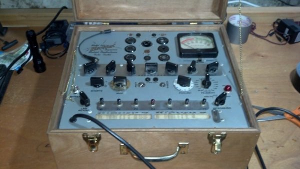

    Along the way as I collected more gear and did more of my own work I also got more test equipement. I picked up this tube tester off ebay. All it needed was a new rectifier to work and we (dad and I) built a new wood case for it.

    Power amp- the Mac MC-240 I mentioned above. I did all the restoration work myself.
    • I wanted to build a full mac system with a C-22 pre and MR71 tuner but collector prices are out of my range :(

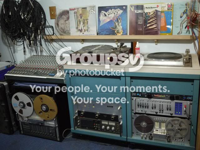

    Very cool little H.H. Scott that got you into this whole thing. I had one, maybe even the same one, years ago. I wish I still had it, I'd send you the knobs. Finding those knobs for the stacked tone pots has gotta be tough.
    I used to be really into the whole audio thing, and actually it's led to what I do for a living now, which is marine electrical design for boat builders with a little service thrown in there now and then. That's how I'm here so much, I'm usually sitting here drawing schematics and other documents like wire schedules and such. I learned it all from my guitar amps and wiring up studio stuff. I don't do too much of it lately, I'm too busy playing with stove designs and just plain working, but I still love the stuff.
    A couple quick shots I just took of my studio/stereo room.....

    nice studio! Like the reel to reels, never got into that myself.
    When it comes to audio nothing beats vintage American big Iron!
