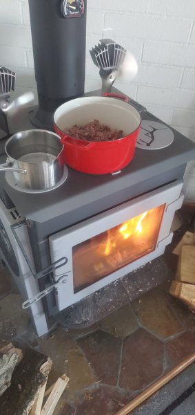

    I heat our 2300 square foot 2 level (upstairs and a daylight basement) with our IS that I purchased in 2015. It's located in the daylight basement in the north corner 5 feet from the stairs to the upper level. It will heat our whole house with downstairs being toasty (70's) to borderline hot (mid 80's), and upstairs to (65 to 70) at the furthest southern bedroom.
    When engage the the flames slow and dance. The only time they disappear is if I turn the air WAY down (like last few notches on the gauge). After a few hours into the burn the flames will die down but still flicker. I've had back puffing at times where the wood gases build up and ignite causing a flash of flames (typically damp outside and the stove was turned down too much) A little air added reignites the gases and no more back puffing.
    There are plenty of flames in the IS box at all burn stages in my opinion, with awesome secondaries at the beginning (looking like dozens of 4 inch torches driving out the ceiling of the stove) to lazy glittery dancing flames well into the burn turned down to really cool blue flames towards the coal stage. I burned a load last night of elm and once it reach its cooling stage it was read with blue flames! AWESOME!!!

    Pretty impressive. I had a Woodstock Fireview. It would have nice secondary burns for a while then no flames. Just the glow from the cat. The secondary burn tubes in the IS must really help keep the flames going.

    Even after the secondaries are done and aren't firing off anymore, the firebox still is very active with a wavy, lazy glittery flame. It's pretty cool to watch and it produces great heat.

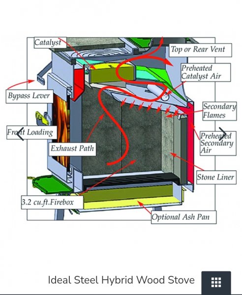

    I was looking at a diagram of the IS and I see they have a secondary air tube directly under the catalyst. Wouldn’t there be a flame coming out of that and cause flame impingement on the catalyst?

    The secondary air comes out through the plate back behind the catalyst opening that's near the front top of the stove. There's no impingement as there's an opening near the front (where the catalyst sits when the bypass is closed) in front of the secondary air system.
    Here's the diagram Woodstock has on there website.
